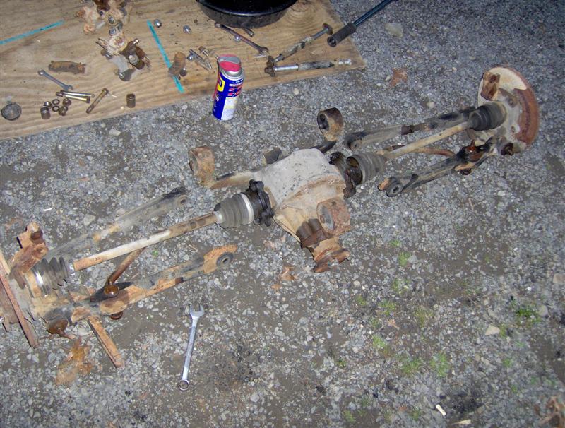

Well guys, since I wasn't able to make it to the meet I figured I'd let you all know what I've been working on. I started this project in April and its so close to being finished but I just couldnt do it in time for the meet.
I've been spending every minute of my spare time and even half of my family vacation trying to get it done. So much work  :(
I've got some pictures for y'all since I couldnt bring it to the meet to show it off. I've swapped the engine to a 1.8 out of a ford escort GT, plus the BP26 (BPT) turbo goodies. I'm using the old turbo from my B6T hybrid'd with the BPT turbo. I got rid of the FWD and forced a Mazda 323 GTX drivetrain in, so yes it is AWD. Its been insanely hard and needed way more parts than I ever expected. I dont have any recent pictures 'cause my camera is dead but I'll have some up soon. I need to take a break from working on this for a bit, its really burnt me out. I've been working 100% by myself, I even took all the pictures of me with the camera on a tripod...
Anyway here are some pics:
1.8L Turbo All Wheel Drive Capri... the "GTXR2"
